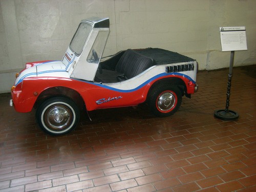

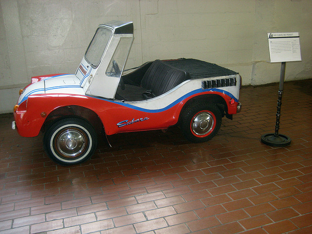

Here is a photo of my 1971 modified subaru 360. Has anyone seen another one like it?
Re: New member Shelton Wa
#12 Post by Sigmaz »
Yep, I think the builder of your micro-micro may have gotten his inspiration from the peanut.

I read your other thread first, the PEANUT is
one of the 2 Mort Smit created.
