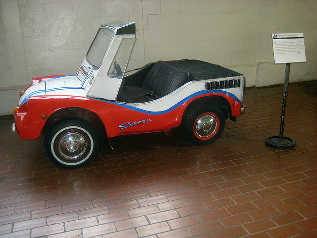

Here is a photo of my 1971 modified subaru 360. Has anyone seen another one like it?

Yep, I think the builder of your micro-micro may have gotten his inspiration from the peanut.

Too Cool (The peanut)
Re: New member Shelton Wa
#14 Post by subaru360nut »
I read your other thread first, the PEANUT is
one of the 2 Mort Smit created.
