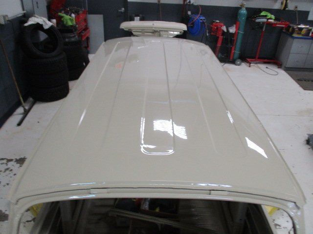

WE are attempting to fit a piece in that hole on Monday. A whole roof would be nice, I'm jus afraid to drill it off at the welds. The whole
thing would have to be braced. Im sure shipping would damage the roof you have? We thought we would try making a piece and if that
didn't work we would look for a parts car?
If we had your van body, we would remove the roof on your van first to see how it was assembled. We like to drill the spot welds out instead of cutting.

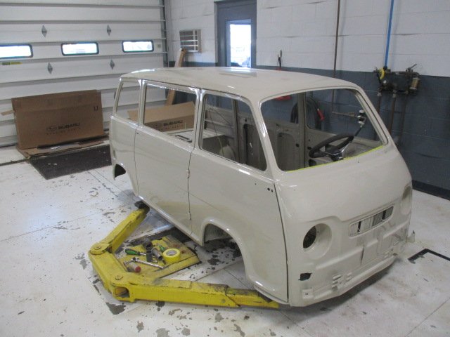

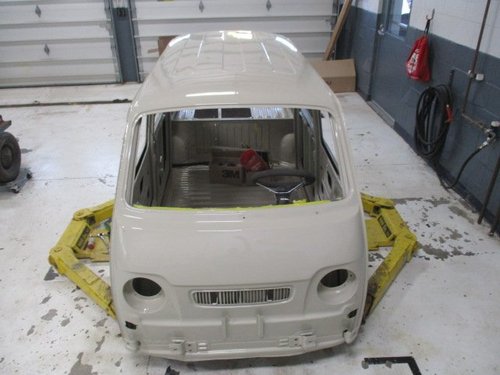

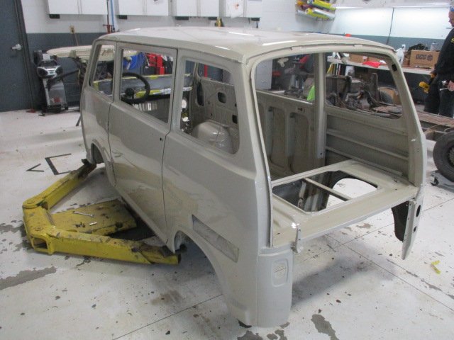

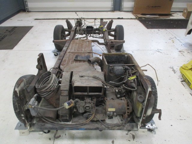

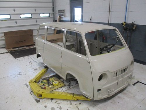

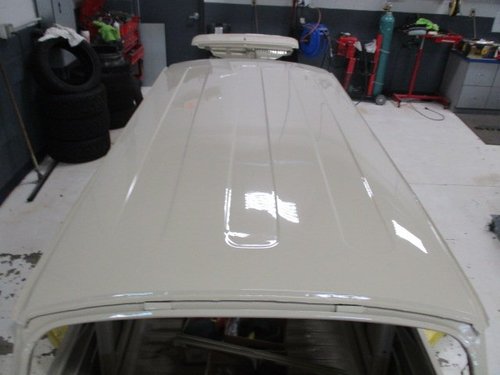

UPDATE
Here is the van as of today. Making good progress but still have much to do!
No more 80"s, Disco, Mystry Machine, BUBBLE TOP, Shaggin Wagin! Or whatever crazy name
it had?

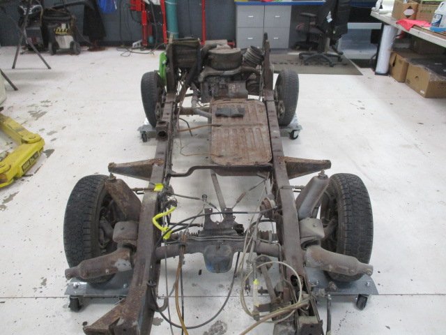

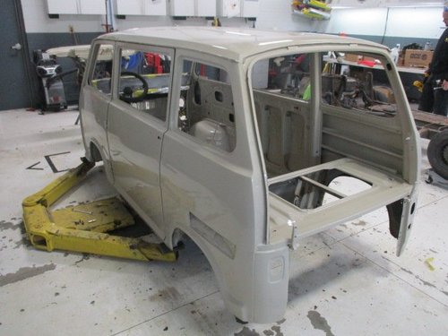

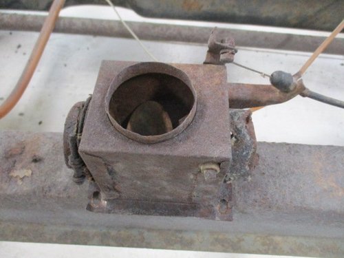

More photo's

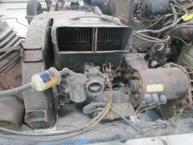

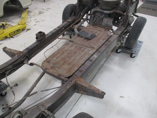

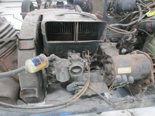

#17 Post by SCOTTW »
just a few more

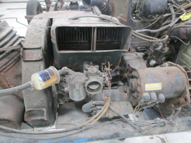

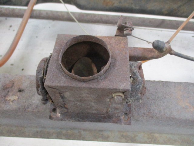

Where can i get the heater/valve or whatever its called?
I am looking for the air filter housing and the Top engine cover.
Thanks !

That bodywork is great - it's a different van! :D
