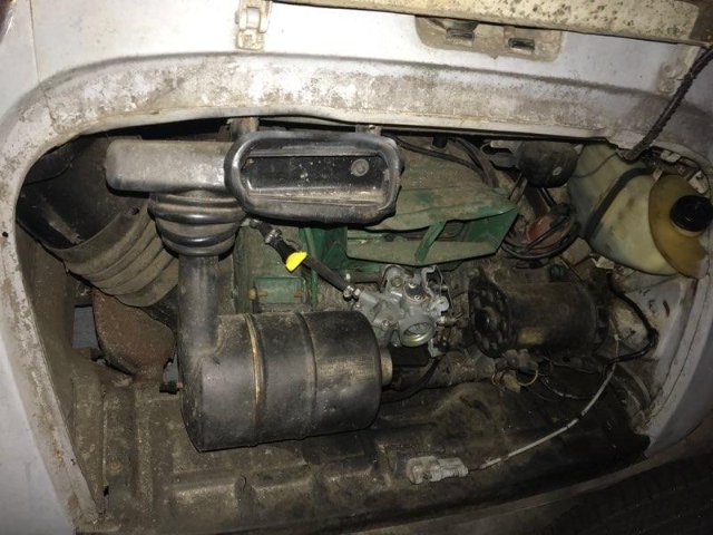

Hello Subaru guys and gals. I'm a proud new owner of a 69 sedan. I've been looking for one of these cars for almost 10 years now. I finally found one in decent enough shape to start this endeavor. It's been sitting in a garage for almost as long as I've been looking for it. Call it destiny. Let me give you folks The rundown.
1). It has not run in over 10 years. Power coming from coil. But no spark. I would like to upgrade to electronic ignition I think this would solve the problem. Can someone tell me who to get in contact with buy one of these things.
2). The Vacuum assembly thing (forgive me I don't know what it's called) underneath the gas tank is missing. If this is a crucial part I need to purchase one from the community.
3). Right rear brake is seized all the rest just need to be used. can someone tell me who I can send the cylinders to get them upgraded / repaired.
4). The brake fluid reservoir is low what type of fluid should I use and should I flush it?
5). Should I go through some procedure to get this thing going again being that it has sat so long. Mainly is there some kind of startup sequence that I should be going through.
Thanks in advance to all those of you who can help.
