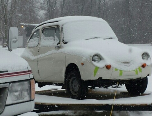

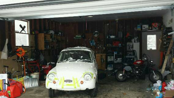

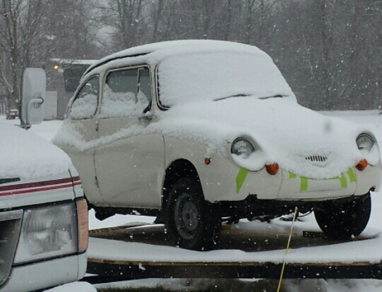

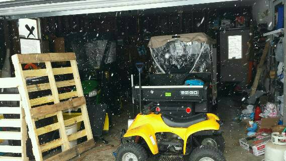

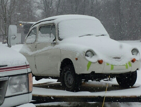

This is the second day of ownership , he had to wait outside while I cleaned up the garage

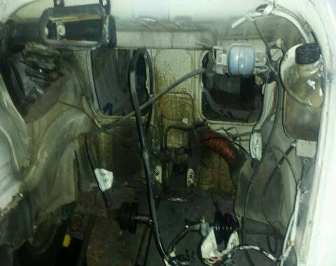

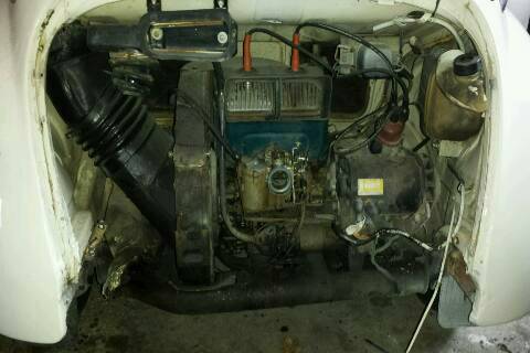

Day's 2 and 3 just assessing the situation. And seeing how everything goes together

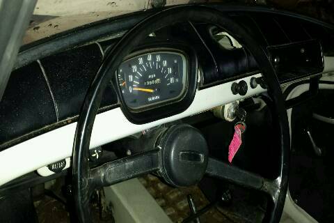

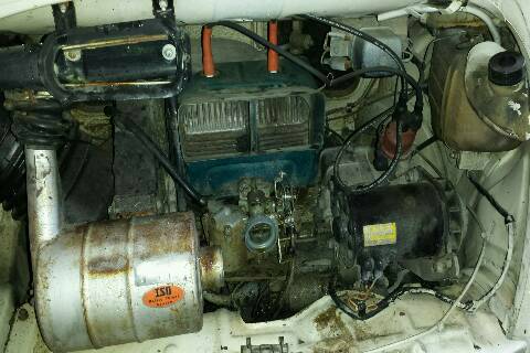

Still day 3 , was told it ran 5 years ago.  Very neglected
Day 3
Day 3
Beginning of day 3 of ownership , random pictures trying to assess the situation and grasp what needs to be done

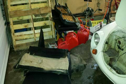

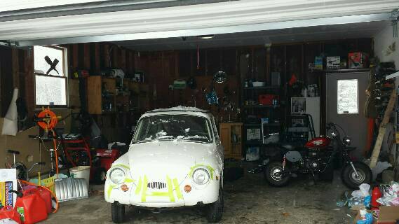

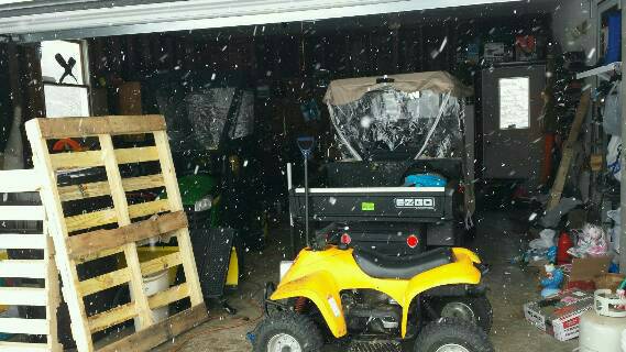

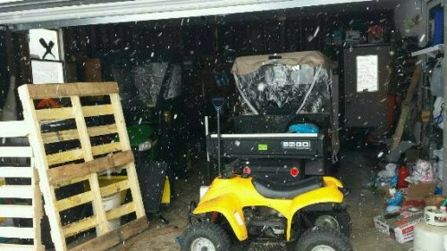

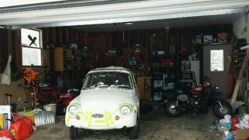

Making room for Yoshi in the garage,  moving stuff to the barn

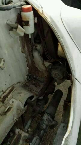

Dirty engine bay, broke exhaust spraying throughout

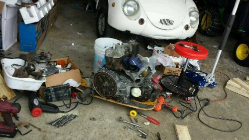

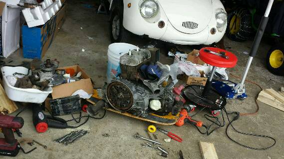

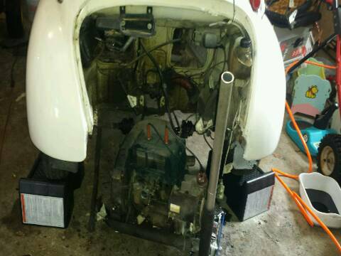

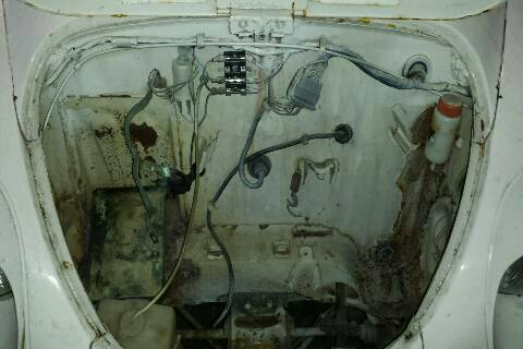

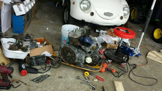

Dropping engine day 6-7
Starting to pull engine day 4

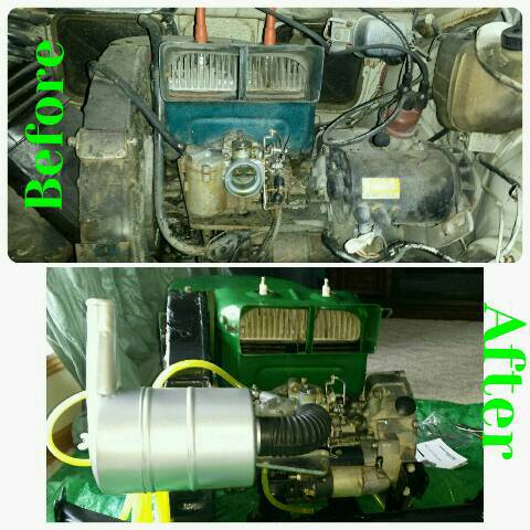

Going into week 2 of fix up

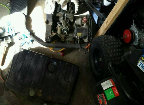

Pulled fuel tank about day 9

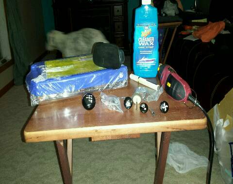

Noise maker cleaning on a slow day
Killing time watching TV restoring knobs

Welcome! Maybe you can teach us stuff too. What did you use to polish the knobs?

Hey micro image,
I used a buffing wheel on a dremel style tool , boat or car wax and a paint marker to fill in the designs (using a paperclip as a paint brush). This idea was courtesy of Mark , via youtube. At 2stroketurbo .
I have simply applied high heat to knobs/steering wheels in the past using a torch when restoring tractors and they magically look like new but CAN'T RECOMMEND DOING SO on the 360 as I have yet to test it and am sure the plastic compound is different .

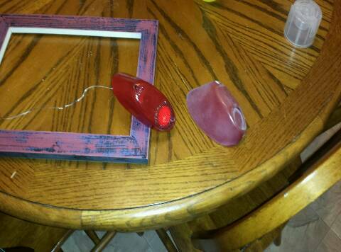

Tail Light restoring
Tail Light restoring.  Looking much better

Micro image, the tail lights were wet sanded with 600 grit , then 1200 , then 2000. And finally cleaned and clear coated
