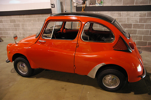

I Just joined this group recently as I bought a 360 Young S car last month. Many of you probably saw it listed on e-bay and other sites.
Couldn't resist getting it. I'm a DYI also and like working on car projects. Never seen so much effort put into this car to save weight.
Even the Z06 (had a 08' model) engineers can learn more from this car.
This 360 hasn't run since 03' according to the last owner. But it does turn over by hand.
I'm starting with the brakes first. There wasn't one drop of brake fluid in the whole system. I read the BOR and some posts here
and ordered the wheel cylinder parts and the cup for the master cylinder. I noticed the MC is thinly brass sleeved. Is this original? The wheel cylinders
are mostly pit free somehow. Anyone ever use DOT 5 fluid? I have had good luck on other non ABS cars with it.
Also should I put in those Axle seals and fan seal I saw posted? I freed up the E-brake and all the other cables. Does anyone make those E-brake

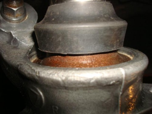

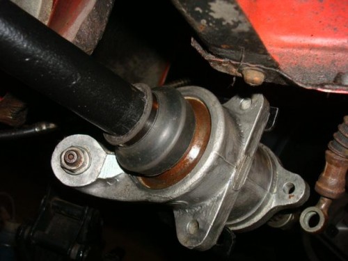

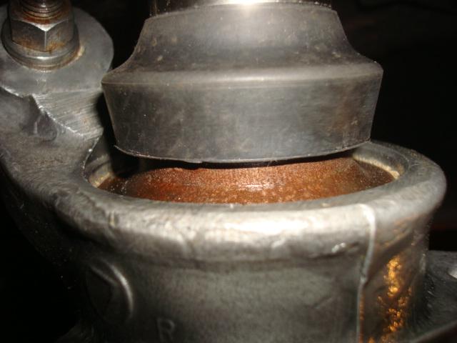

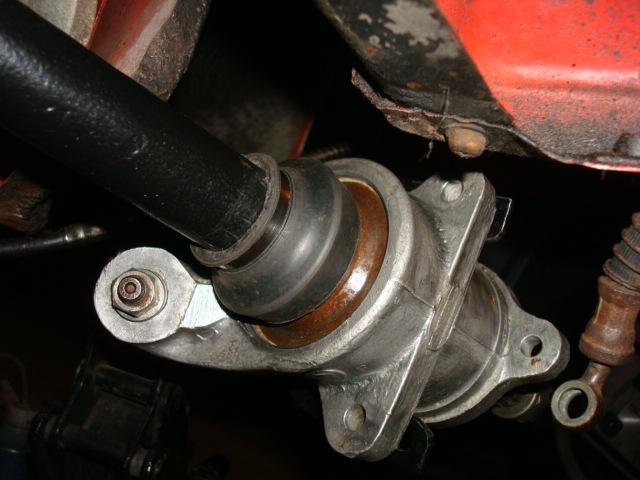

cables? Also got new boots and those small rubber collars that goes on the back side of the axle bearing housing. On that part if I slide it
over that metal flange on the bearing housing, it squeals as I turn the axle. Should I grease it or just not push it up on the flange - see pic.

Welcome! Another Young! I really have no guidance to give on that. I'd say grease it but I have no experience with this part. As I understand it the metal part it is going up against is stationary, is that correct? The rubber pc is somewhat a slinger and a seal. If anything gets on the rubber part it slings it off and it doesn't get under the lip and into the bearings. My 2 cents. You didn't happen to get any extra Young parts like a gear shift knob.

The brass sleeving is not original.
I have used DOT 5 in the past and plan to on my 360
The only replacement for the e-brake cable is a motorcycle clutch cable viewtopic.php?f=40&t=4783
I am replacing my seals to avoid trouble later
Don

Thanks for the replies. I probably Q-Tip a little grease on that flange end and see what happens.
DOT 5 fluid is paint friendly which is good for these cars. I guess when I get it going,
I will see what leaks, or if the axle seals leaks and fix it later.
Garen
