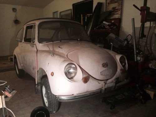

Hello my name is Khalid, I'm from Palm Springs CA currently working on my brothers 360 Sedan with OT. The car is running but it needs brakes. I'm going to replace all the wheel cylinders and brake lines. So far I noticed the wheel bearings aren't rolling easily. Another problem is that my rear passenger shaft boot is leaking gear oil. I'm so glad that this discussion forums exists because I'm a DIY as long there is information there's a way to mend this car back to the road. I will post pics of the build.

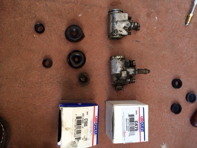

I was able to salvage the brake lines and ditched replacing the old cylinders. After cleaning the brakes I was able to determine that brake shoes has still a good lining on them. I was able to buy rebuild kit from car quest for the rears perfect fit part# c7880 And for now I'm using cups part# c675 for front brakes. Honing the cylinders was kinda fun.It's a temporary fix and will probably just have the front pistons resleeved. So far I have good brakes without leaks on all four wheels. Now the bad I need a new castle nut( never ever use an impact gun on this car) and fuel valve has a small hole. Maybe I need to rebuild the valve, anyone who has a spare would be glad to take it from your hands. I'm still waiting for my axel boots to arrive but that's another story.
Here are the parts I used to rebuild the cyclinders.

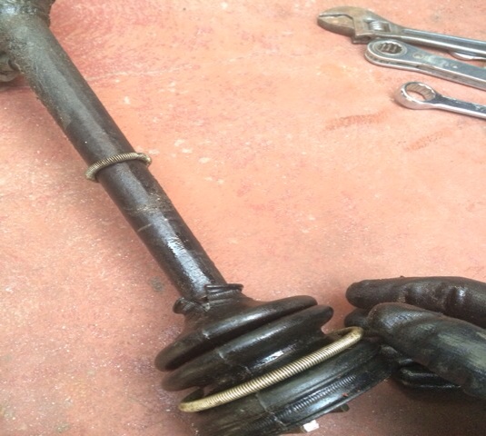

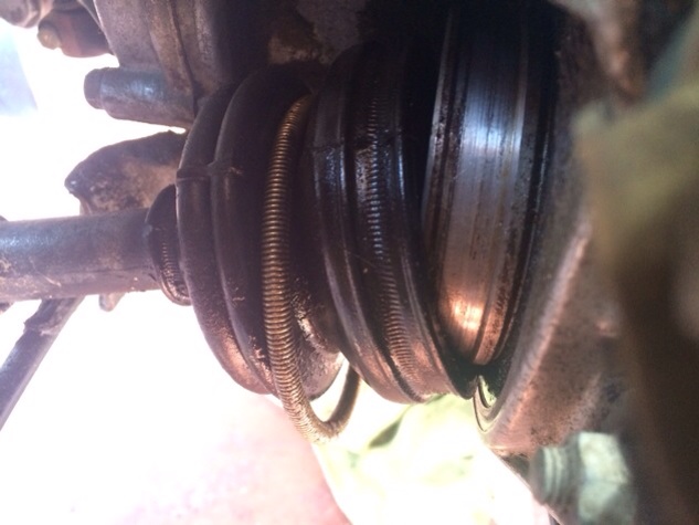

Yea@ sigmaz I opened the fuel valve found that the nipple was badly torn good thing it's an easy fix.I ordered two nipple parts from Jon just in case. Thanks @micro image I hope you can find that spare. Well while waiting I'll be replacing the axel boots.(it looks like it's going to be a challenge)
Here's the easiest part of removing the boot

Is the rubber boot torn, or has it just slipped off the axle flange???? If not torn, clean up the flange & boot slide it back on & roll the retaining spring back on. Then fill the gearbox before running.

Yes, there is a tear on the axle boot. After changing the gear oil, I could see the fresh gear oil slowly dripping on that rear right axle. I received my replacement boots from ebay but my excitement was short lived due to another problem, Blown shocks :? I was able to find some time to remove the rear right axle this evening for cleanup. New boots will be installed tomorrow.

xfunkyflipx wrote: 12 years ago I was able to salvage the brake lines and ditched replacing the old cylinders. After cleaning the brakes I was able to determine that brake shoes has still a good lining on them. I was able to buy rebuild kit from car quest for the rears perfect fit part# c7880 And for now I'm using cups part# c675 for front brakes. Honing the cylinders was kinda fun.It's a temporary fix and will probably just have the front pistons resleeved. So far I have good brakes without leaks on all four wheels. Now the bad I need a new castle nut( never ever use an impact gun on this car) and fuel valve has a small hole. Maybe I need to rebuild the valve, anyone who has a spare would be glad to take it from your hands. I'm still waiting for my axel boots to arrive but that's another story.
Any Idea what these parts fit? I don't have a car quest local. I'm fixing Hippie's brakes now. Would like to try them.
