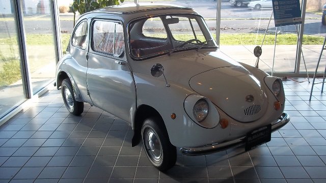

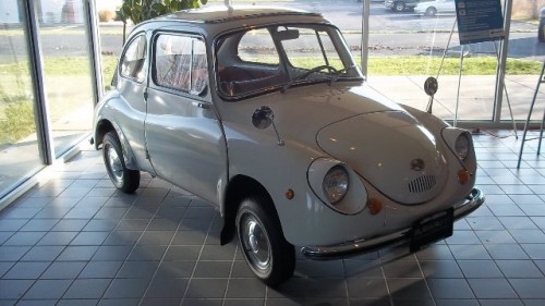

I work for Subaru of America. I bought my 360 sedan late last year from a retiring dealer in Merrillville, IN. It's in pretty good shape. I told him I would take good care of it. It's in the SOA service shop right now. My goal is to drive it to the office a few Fridays this summer...good thing I only have to drive 2 1/2 miles! I bet it's been a long time since someone drove a 360 to work at SOA. The shop told me to find a carburetor. As soon as I can find where to ask I'll post a request on that one. Look forward to learning from the experts on how to take care of my car.

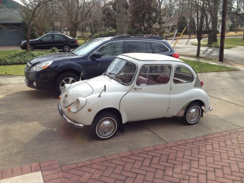

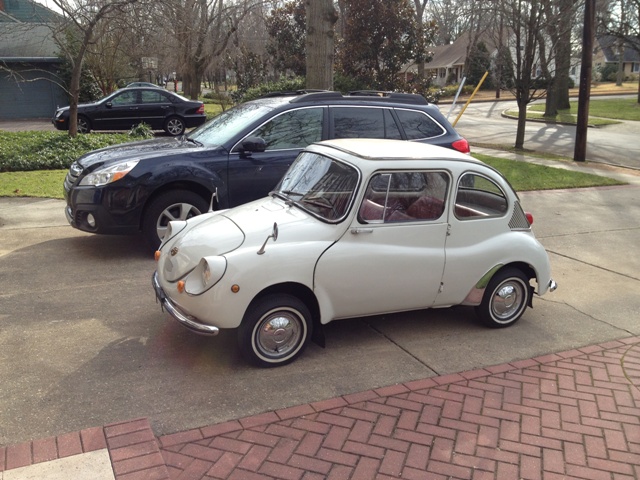

Here is another pic of the car right before it was shipped out to me in December...

Like I said before.. Gorgeous!Jeffery wrote:Here is another pic of the car right before it was shipped out to me in December...
