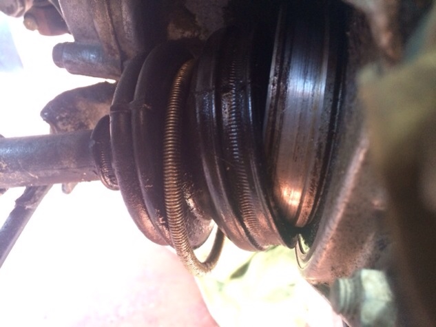

Here's the easiest part of removing the boot

Is the rubber boot torn, or has it just slipped off the axle flange???? If not torn, clean up the flange & boot slide it back on & roll the retaining spring back on. Then fill the gearbox before running.

Yes, there is a tear on the axle boot. After changing the gear oil, I could see the fresh gear oil slowly dripping on that rear right axle. I received my replacement boots from ebay but my excitement was short lived due to another problem, Blown shocks :? I was able to find some time to remove the rear right axle this evening for cleanup. New boots will be installed tomorrow.
