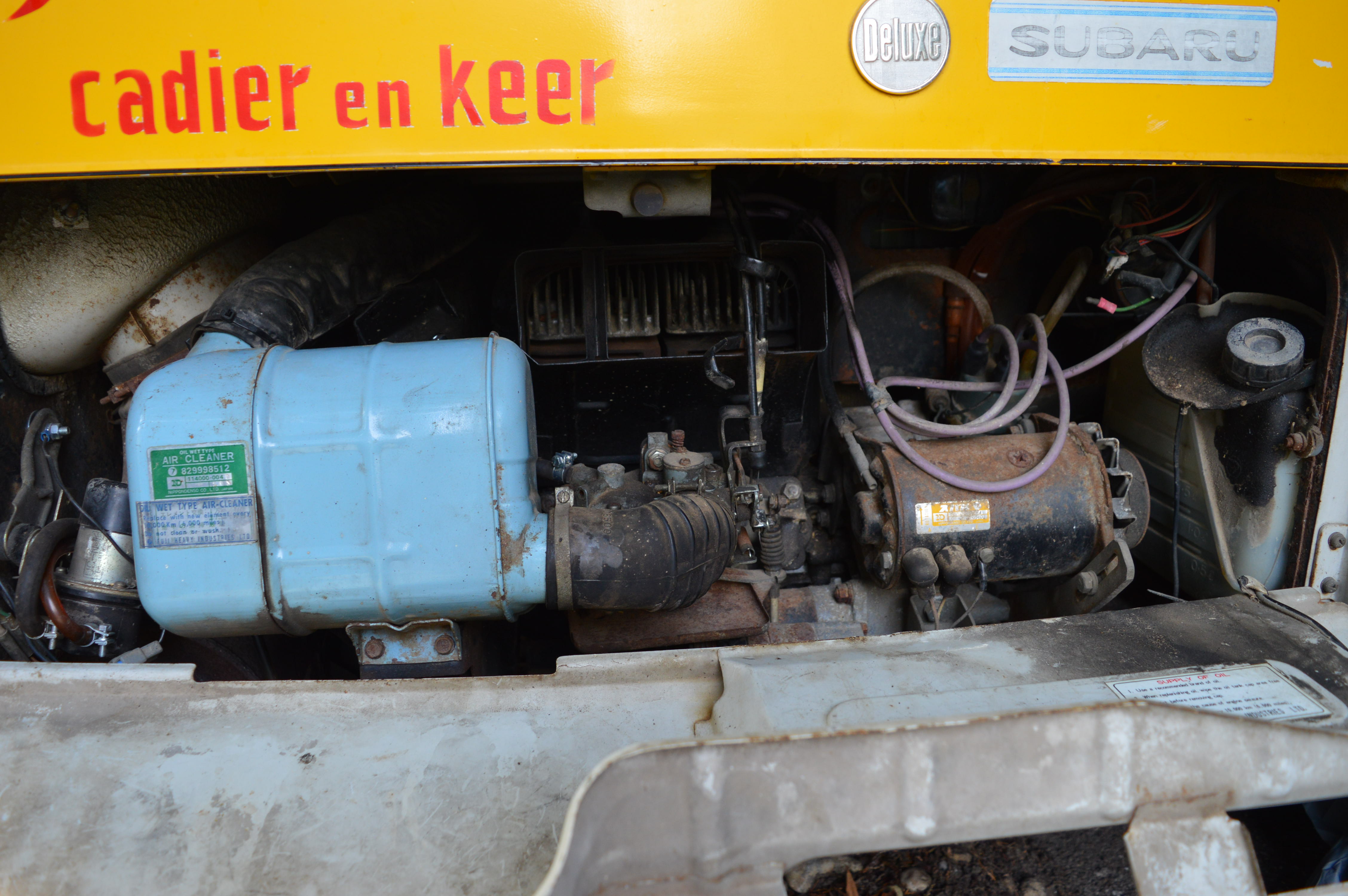

I've cleaned it up a bit since these pictures were taken. When I first started it a huge cloud of shredded newspaper and grass exploded out of the aircooling shroud. I think I evicted a family of mice. I also took out that janky electric fuel pump on the left there. Replaced it with something a bit less... intrusive. But now my carb is overflowing. Don't know if the new pump is to blame or if it's my float. Does anyone have any thoughts about fixing the original fuel pump? That would be ideal, of course, but I'm not getting my hopes up. Maybe it's best to take the whole engine out, get all the dirt and rust out of the engine bay? What do you guys think? Good idea? Bad idea?

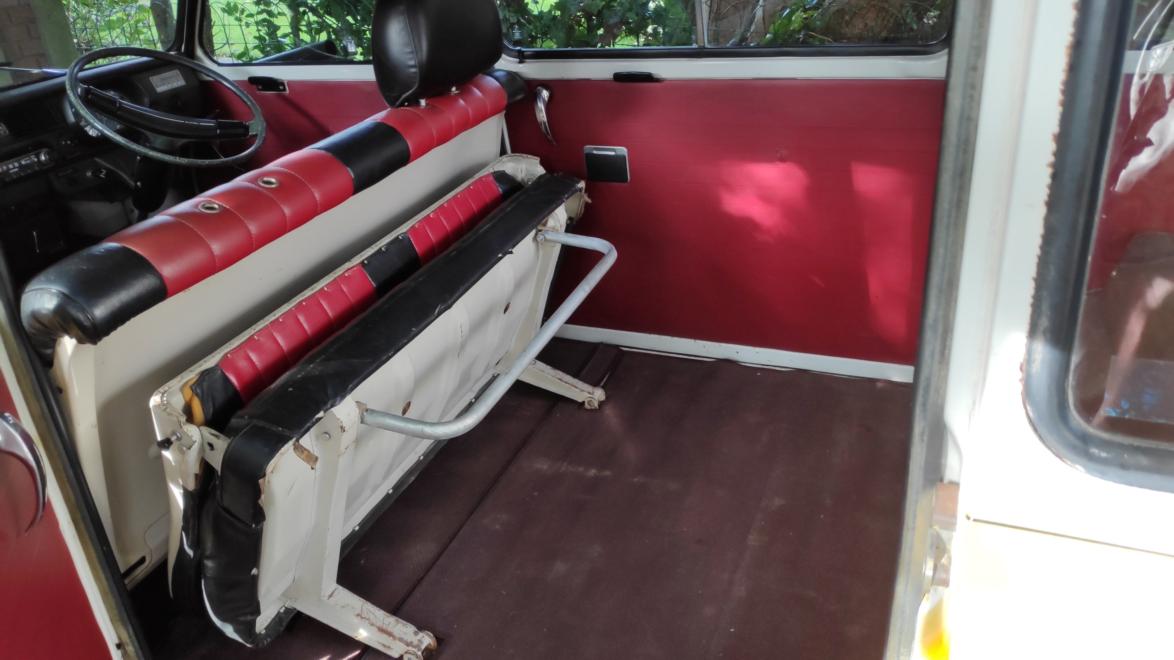

What's with that headrest tho? Is that lost or was it optional?

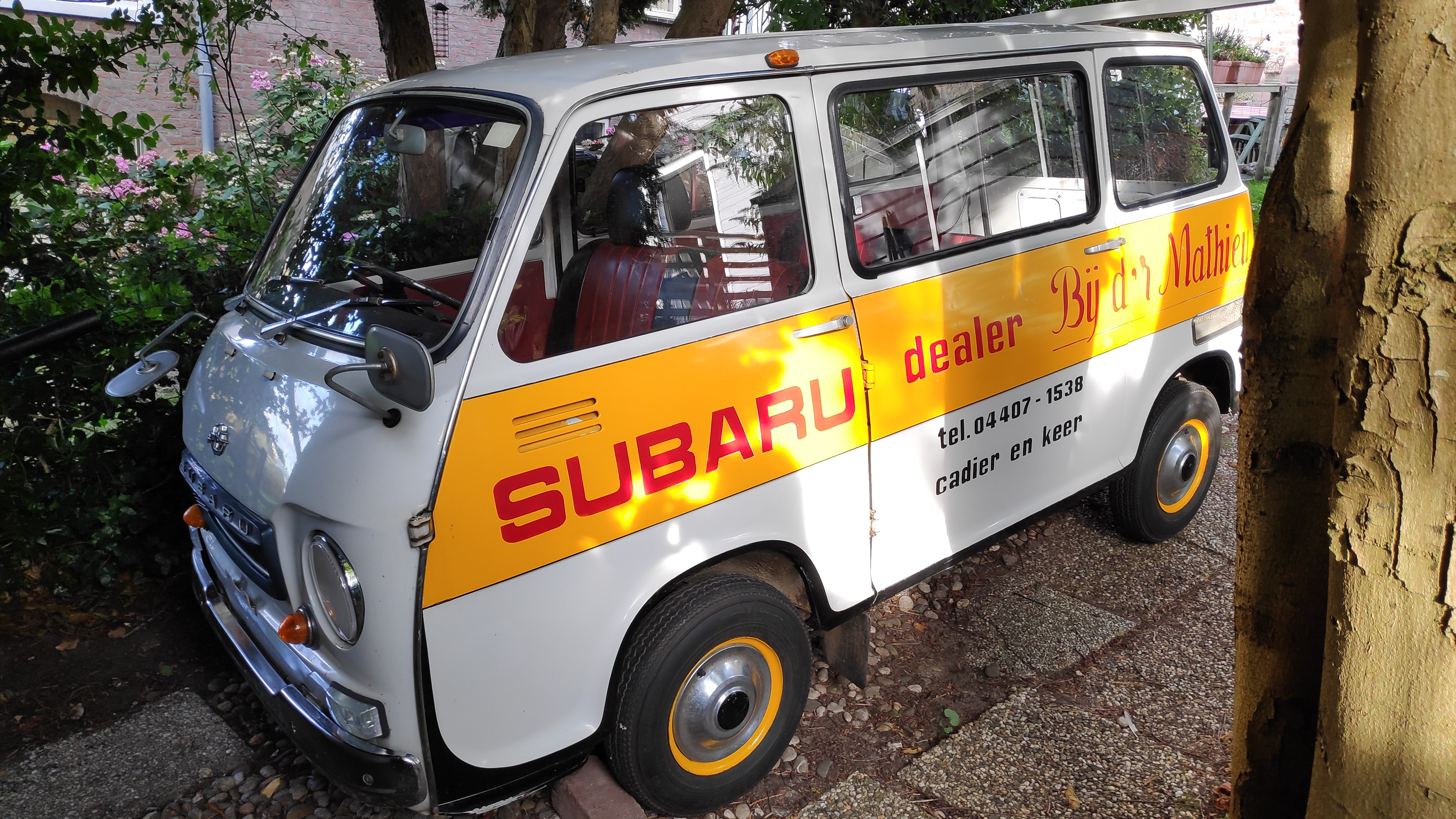

Oh, and I almost forgot to mention: As you can probably tell from the pictures, at some point in the van's life some flapdrol thought it would be a good idea to cut 4 great big holes in it and put some big orange Volkswagen Beetle turn signal lights on it. So yeah... that happened.

Welcome to the club. That's a really nice Sambar. Great history. The most common problem with the Org Fuel pump was the check valve springs broke & it fail to pump fuel afterwards. The pump is easy to remove & dissemble, I have had new stainless steel springs made. Most Elec pumps put out too much pressure for the float & needle& seat to control causing flooding.

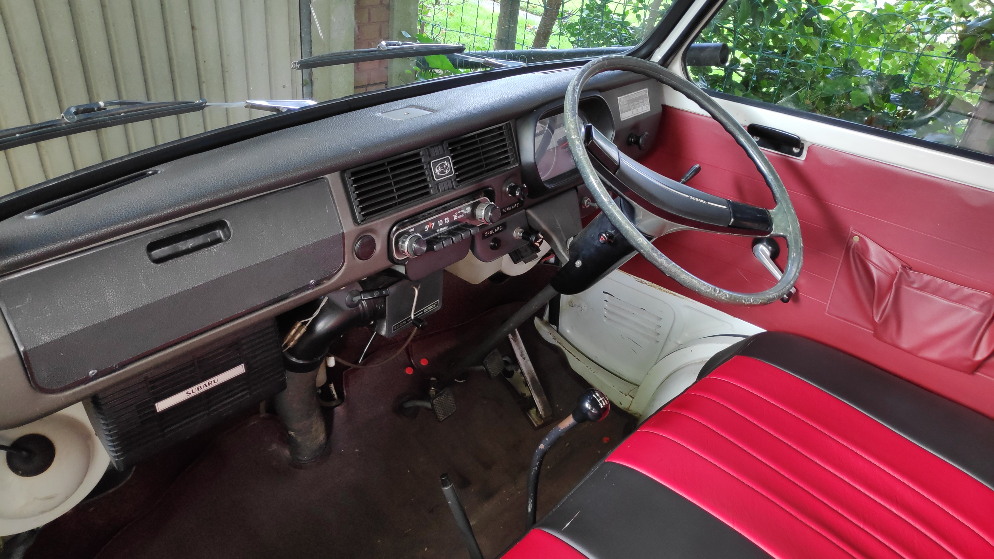

And I've been meaning to ask, what is that thing that looks like the choke, but on the opposite side of the steering wheel? The knob's missing so I can't tell from that, and pulling it doesn't seem to do anything obvious.

Previous Owner made an "improvement" that only he/she understands :roll:
