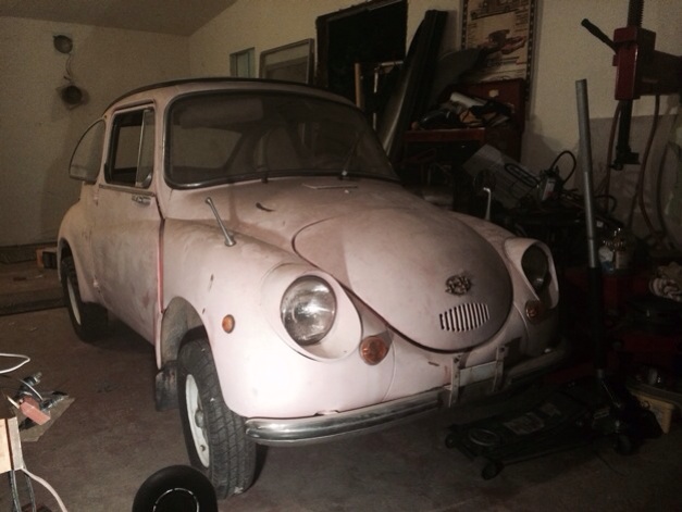

Hello my name is Khalid, I'm from Palm Springs CA currently working on my brothers 360 Sedan with OT. The car is running but it needs brakes. I'm going to replace all the wheel cylinders and brake lines. So far I noticed the wheel bearings aren't rolling easily. Another problem is that my rear passenger shaft boot is leaking gear oil. I'm so glad that this discussion forums exists because I'm a DIY as long there is information there's a way to mend this car back to the road. I will post pics of the build.

Yessir @ Jorge that car was just sitting at his garage so i told him ill work on it. The car is on jackstands right now at his hous.. I bought some wheel cylinders at carquest ill be getting them this Monday. I'd like to salvage the brake lines but i stripped the bolt ill just have to bend cut and flange new ones. Im gonna search this forum for anyone who sells brake shoes.

I'll be getting them tomorrow so I'll be posting some pics. I'll be going to a brake specialist tomorrow to have them build some lines. I will try to salvage all the parts and rebuild them. I guess there's a shop in Upland that rebuild the cylinders, Here is what I'm working on.

I was able to salvage the brake lines and ditched replacing the old cylinders. After cleaning the brakes I was able to determine that brake shoes has still a good lining on them. I was able to buy rebuild kit from car quest for the rears perfect fit part# c7880 And for now I'm using cups part# c675 for front brakes. Honing the cylinders was kinda fun.It's a temporary fix and will probably just have the front pistons resleeved. So far I have good brakes without leaks on all four wheels. Now the bad I need a new castle nut( never ever use an impact gun on this car) and fuel valve has a small hole. Maybe I need to rebuild the valve, anyone who has a spare would be glad to take it from your hands. I'm still waiting for my axel boots to arrive but that's another story.

Yes, there is a tear on the axle boot. After changing the gear oil, I could see the fresh gear oil slowly dripping on that rear right axle. I received my replacement boots from ebay but my excitement was short lived due to another problem, Blown shocks I was able to find some time to remove the rear right axle this evening for cleanup. New boots will be installed tomorrow.
